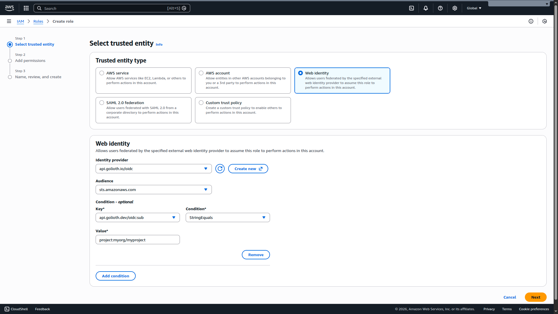

3. Create a role​
Next, we need to create a role that Golioth can assume when it connects to AWS. In the IAM Roles section, click Create Role.
Under Trusted entity type, select Web identity, and select the Identity provider and audience you created in the previous step.
Add a condition by clicking Add Condition. Under Key, select api.golioth.dev/oidc:sub. Set Condition to StringEquals, and Value to match the following format:
project:<golioth-org>/<golioth-project>
Here, <golioth-org>/<golioth-project> is the organization and project slugs for your project, as seen in the Golioth Console. For instance, if the Golioth Console URI for your project is https://console.golioth.io/org/myorg/project/myproject, Golioth will use project:myorg/myproject as its token subject when connecting to AWS.
warning
The condition is the mechanism that allows AWS to control which Golioth projects are allowed to connect to the Private CA. It is crucial that the condition is included in the role definition, as failing to add this will allow any Golioth project in any organization to connect to the Private CA.
Create a role

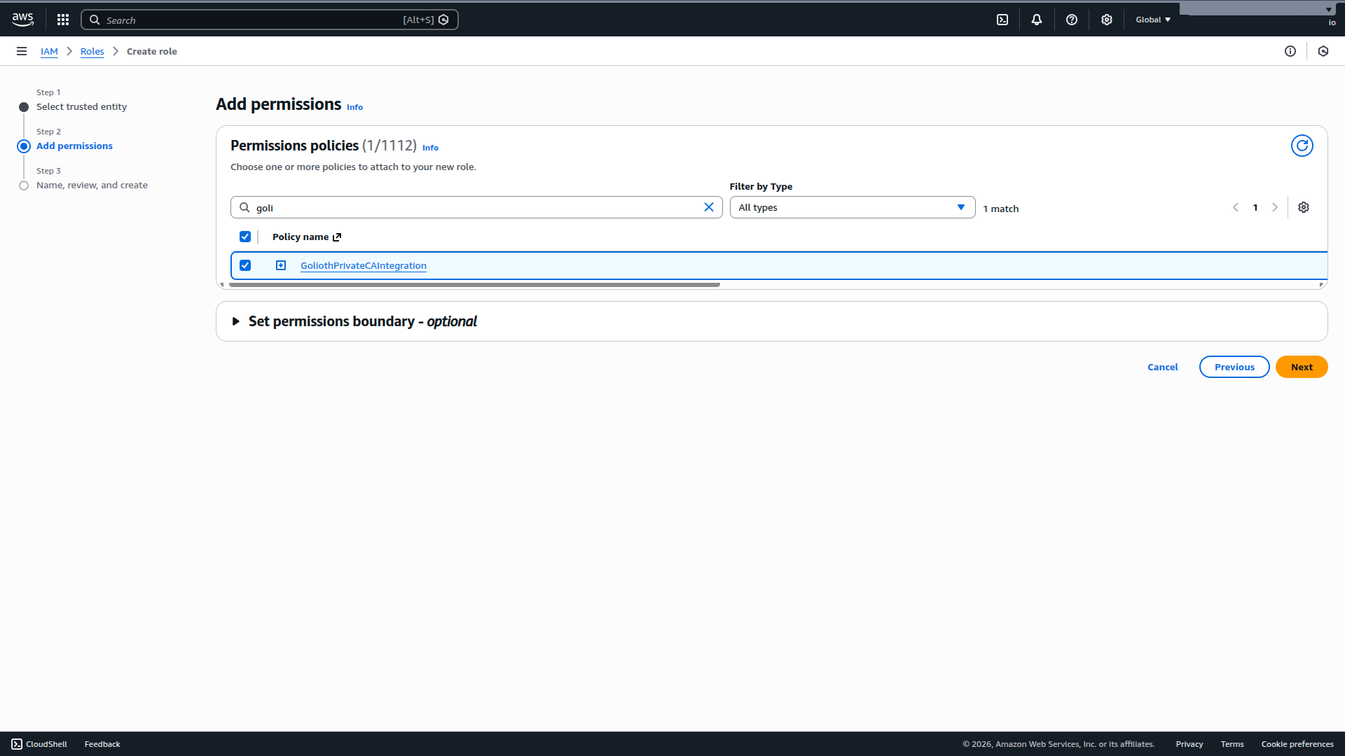

4. Attach the policy to the role​
In the "Add Permissions" screen, search for the policy created in step 1. Select the policy, and click Next to go the final role creation page.
Attaching the policy
Finally, give the new role a name and an optional description and click Create Role.

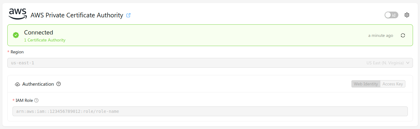

Once you have an AWS IAM role with the required permissions, you can configure Golioth's connection to the AWS Private CA from the Golioth Console. Navigate to the PKI Providers section in the sidebar, and click Add Provider. In the modal window, select AWS Private Certificate Authority, and the correct region for your AWS instance. Under Authentication, select Web Identity, and add the ARN of the role you created in the AWS Console, then click Connect. The provider will be added to the list of known providers, and a provider status check will run.
AWS usually takes a couple of minutes to deploy your policy, and the status check may report AccessDenied: Not authorized to perform sts:AssumeRoleWithWebIdentity status code: 403 or a similar error while your changes are being processed.
Once everything is configured correctly and your policy is deployed, the provider status should change to "Connected", and list the number of available certificate authorities.
